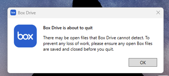

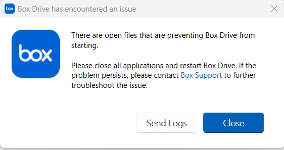

I am experiencing the same with one of our users. I’ve also done the whole uninstall / reinstall / restart.
Eventually I will get this pop up that tells me to send the logs to Box and then to create a ticket. The below also pops up but we have no files open.

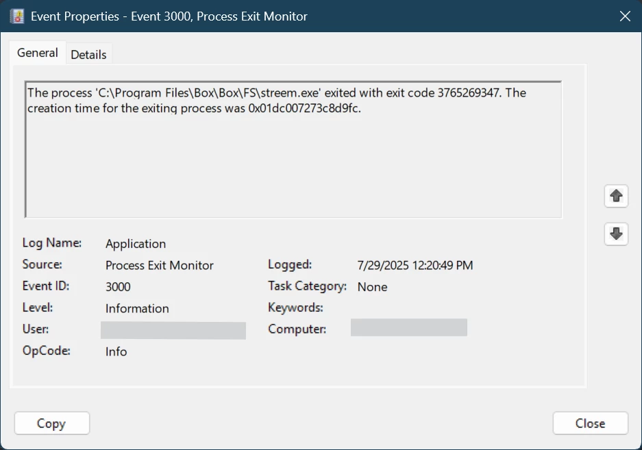

  • July 29, 2025
Further investigation.
There are logs in the Event Viewer, reporting the events:
The process 'C:\Program Files\Box\Box\FS\streem.exe' exited with exit code 3765269347. The creation time for the exiting process was 0x01dc007273c8d9fc.
I am wondering whether it relates to the FLS callback, as the error code 3765269347 is part of the documentation.
https://learn.microsoft.com/en-us/troubleshoot/developer/visualstudio/cpp/libraries/fatal-error-thread-exit-fls-callback
