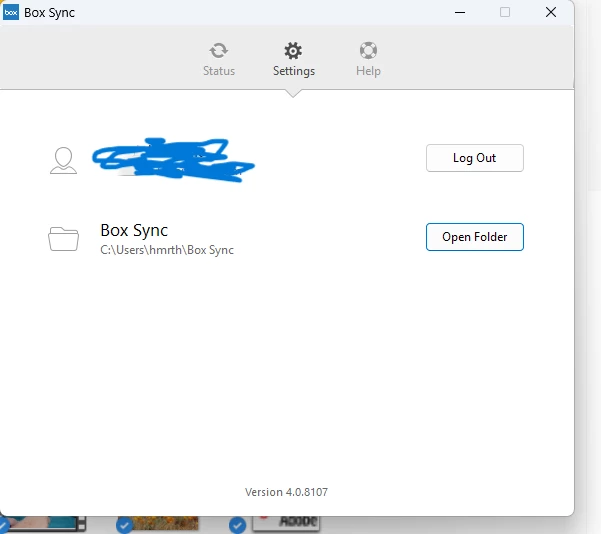

Currently my files sync to a Box Folder located on my C Drive.  I want to move the folder to my D Drive which has more space.  The instructions I have seen all relate to setting the sync location upon install, but they don’t reflect what you can do when it is already installed.  Does one need to uninstall and then re-install Box Sync to change the location?  Seems like there should be an option to change the location.
My Box Sync Options

Hi ​@Hamir the Hermit,
Welcome to Box Community, and we’re glad to assist modify the location of your Box Sync folder.
To do so, please uninstall your Box Sync application and reinstall it.
During your installation, you will be prompted to customize your folder settings, which includes reconfiguring your Box Sync folder location.
For more details, please see this article.
Thanks for posting!

The Solution suggested by Clint194Lee absolutely did not work for me.  I’ll try the next solution suggested.
But the suggestion made by Rona Box seems to have done the trick!  Anyone reading this, follow those instructions!
