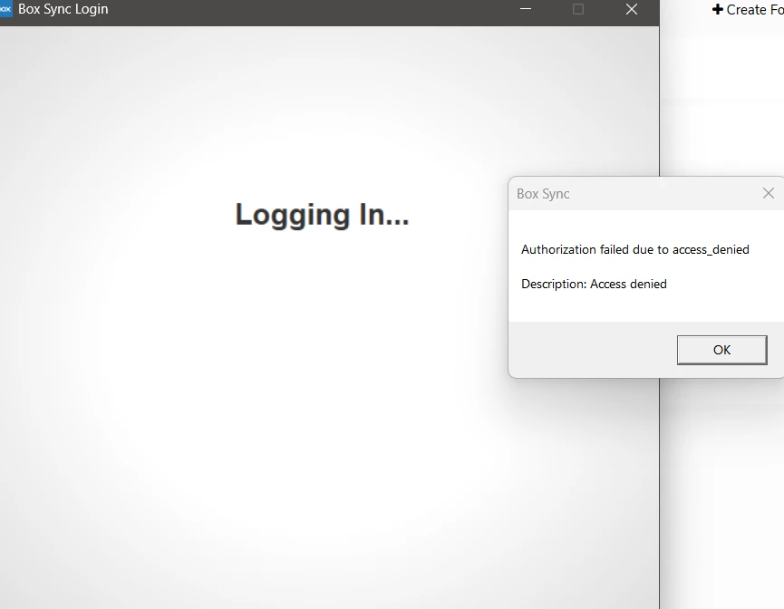

PS interesting! I uninstalled Drive, installed Sync, login worked to the point of email notification but, Sync errors out
