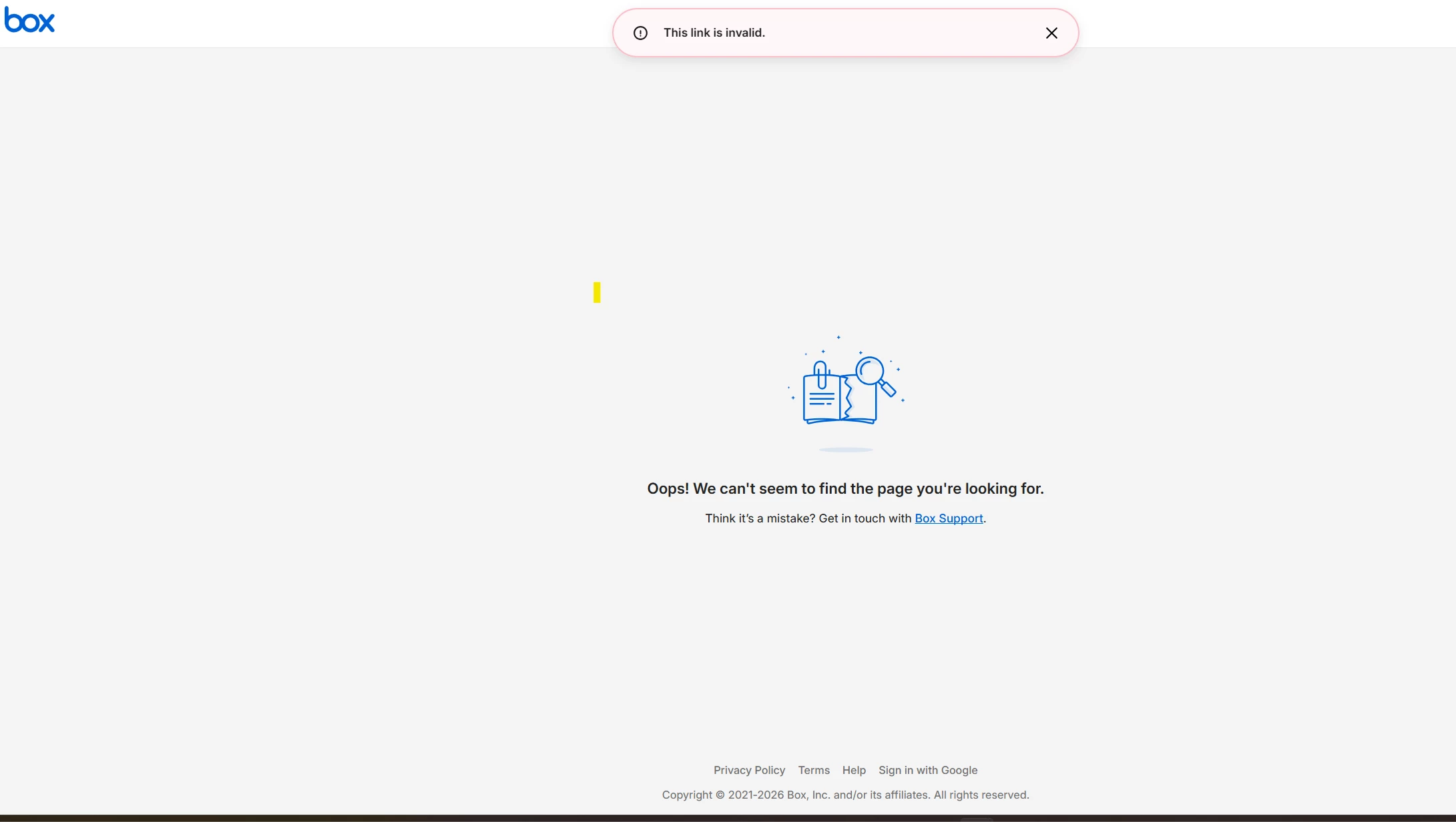

Hi
I currently have a box developer account and i am trying to setup box sign in Salesforce. I did all the configure to the point where I added the “Box Sign” button to the Account object.
So now I am trying to test on how feature would work, and I get to the point where I select a random document from box and when I hit “preview & send”, it would pop up a modal in SF, where eventually after some time it will redirect me to the box.com site, and this is what i end up getting this not found page, so not sure if there are more configuration/setup that still need to be completed?
daria
  • Box Employee
  • October 7, 2026
Hi ​@jcpd - thanks for the detailed description and for sharing the screenshot.
It sounds like the configuration is mostly in place. When you click “Preview & Send,” Box creates a draft signature request and redirects you to a secure Box Sign preparation page within your Box account. The “This link is invalid” error indicates that Box isn’t able to open that draft for the Box account currently active in your browser.
There are a few things worth checking:
  1. Verify the Box account you’re signed in with
    The preparation link can only be opened by the Box user who created the request. Please make sure the account you’re currently signed in to at box.com is the same Box account connected to Salesforce. As a quick test, you can sign out of box.com (or use a private/incognito browser window), sign back into Salesforce, and try the process again.
  2. Check that Box Sign is available for the account
    If you’re using a Box developer account, Box Sign may not be enabled by default. In the Box Admin Console, go to Enterprise Settings > Box Sign and confirm that Box Sign is enabled for your enterprise and for the user connected to Salesforce.
  3. Check your browser settings
    Please make sure pop-ups and third-party cookies are allowed for *.box.com and your Salesforce domain. You can also try reproducing the issue in a different browser to rule out a browser-specific issue.
If the issue persists after these checks, please open a case with Box Support and include the following information:
  • Your Box Enterprise ID and the email address of the Box user connected to Salesforce
  • The version of the Box for Salesforce package you have installed
  • If possible, a HAR file captured while reproducing the issue
This information should give the Support team enough context to investigate the issue further.
Hope this helps!
