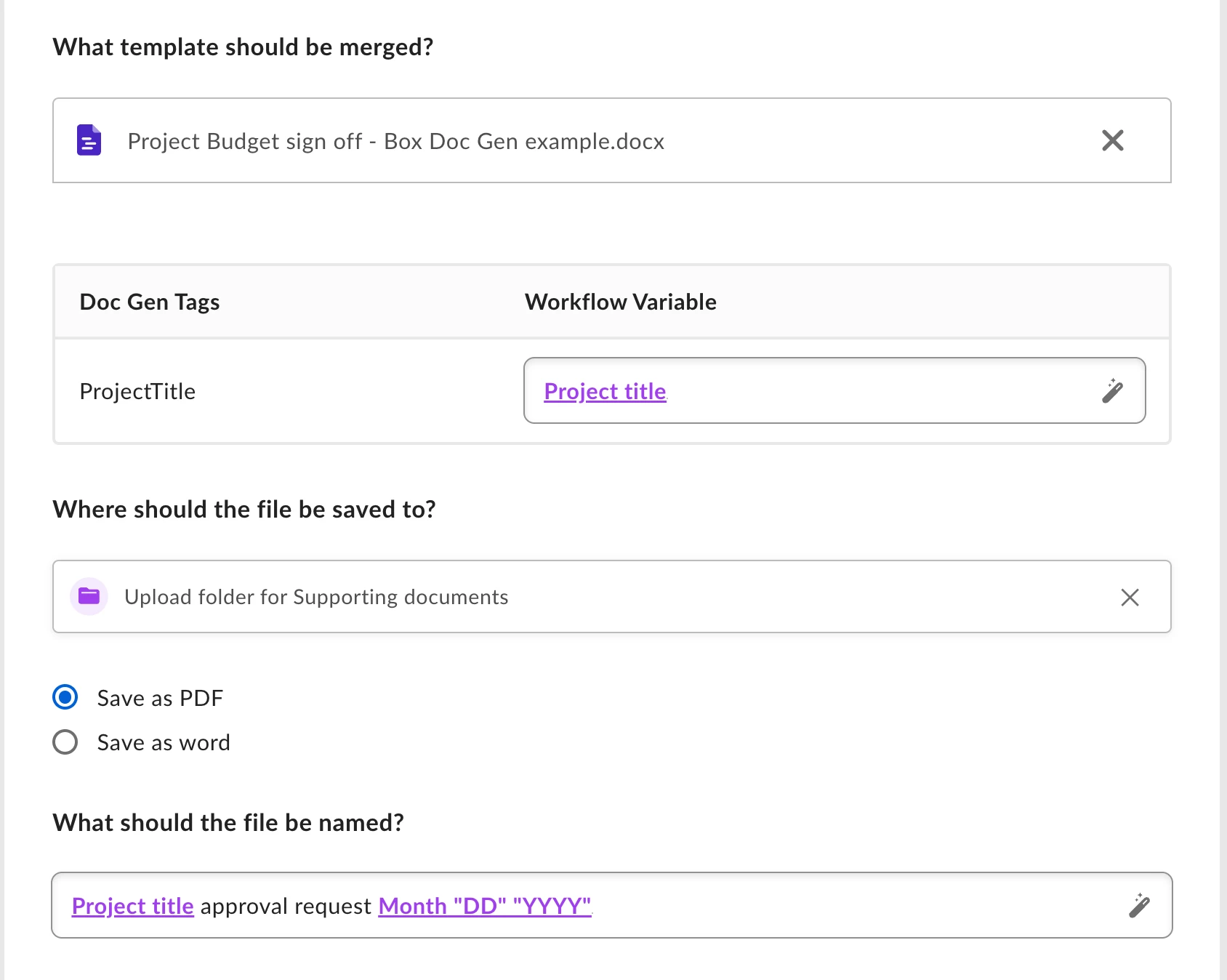

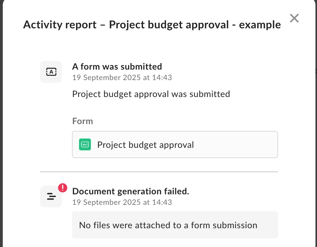

I am trying to set-up my first Box Form from a DocGen and then use a Relay to start the process. I have created a simple document with one field that is linked into the Form on generation. I fill-in the form, without any attachments, and submit. When the workflow ‘relay’ then runs, I get an error ‘No files were attached to a form submission’
I did not think I had to have attachments with the form.
Can anyone provide some advice?

Thanks to some great support from the Box team I have made some progress, in my Relay the on the First Outcome where I had selected ‘ Generate Document’, there is a field to set ‘where should the file be saved to?’ where I had selected the upload folder for supporting documents
Changing this to another folder in Box (a folder for the outcome that i need) and then testing again I now have a working solution.

The error I am getting is
And my workflow looks like this

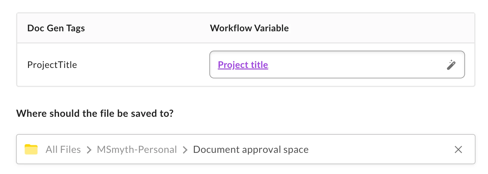

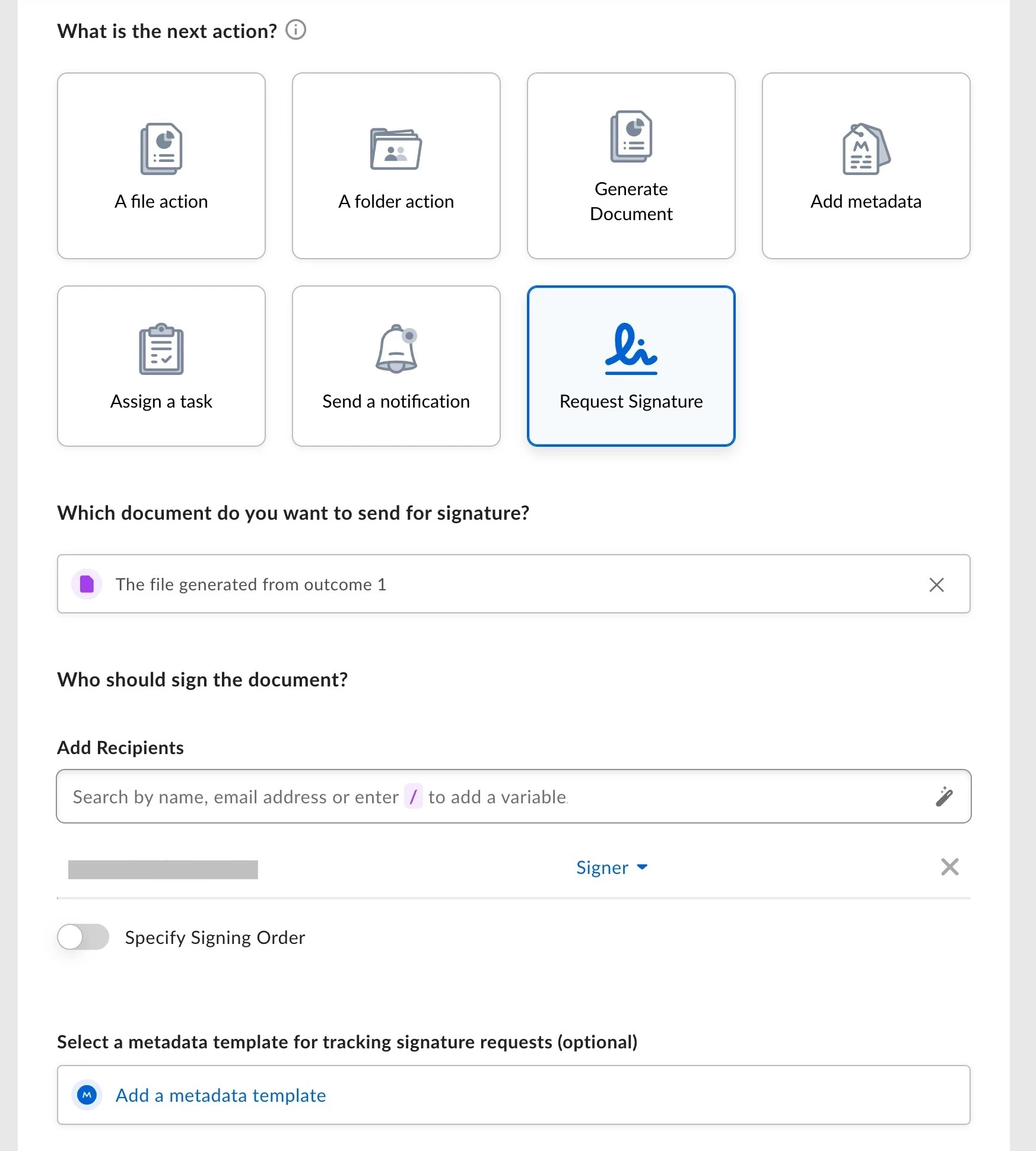

So my aim here was to replace an internal process of ‘Budget Approval’ for which we use a Word document template stored on our SharePoint intranet where nobody can find it, the document is then filled in, put somewhere random in Box. A sign-off with a competing eSign solution is used, with supporting documents not always bundled together and then the signed document is then saved somewhere in Box by staff never to be easily found again because its not centralised in the correct area.
Whilst just an example of whats possible, I can create a Project Budget approval document and use the Box Doc Gen add-in within Word. I create my template linking the fields in my Box Form to the doc gen template. I can Submit a request through the form with or without supporting , this then creates my Project Budget document automatically in Box using Relay and then starts the approval process.
