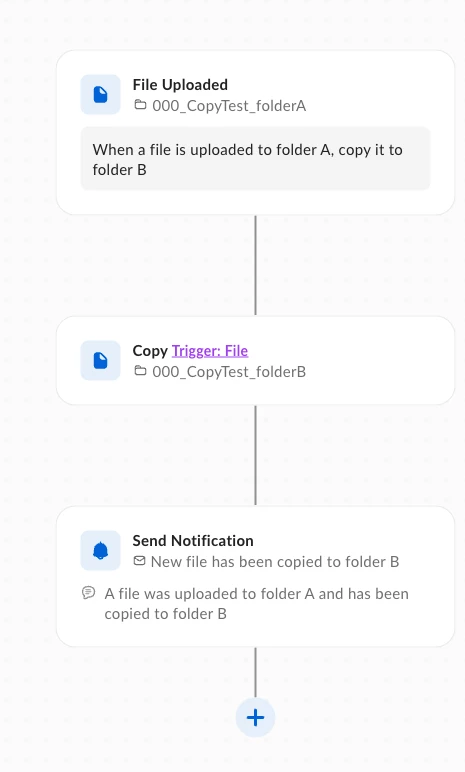

Hi all -- I’ve built a very simple automation where when a file is uploaded to Folder A, a copy of of the file is sent to Folder B and users are notified. This works perfectly when the file is uploaded via the Web interface, but it fails when the file is uploaded via Box Drive. Any suggestions?
thanks much! --rich

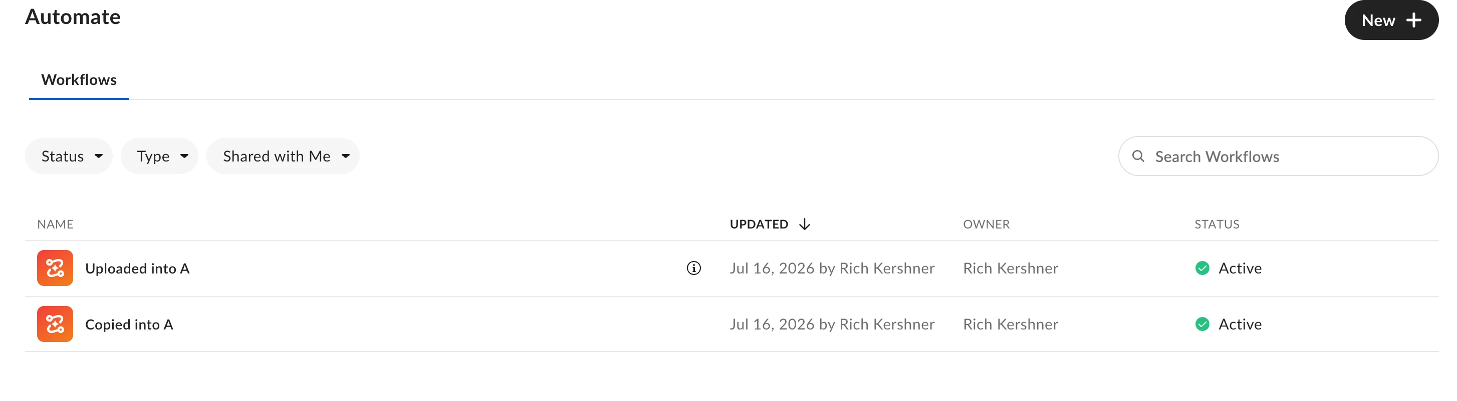

Hi Kelsey -- thanks so much. I was working on a very simple automation where when a file lands in folder A, it gets copied to folder B. I created an automation where an upload to A triggers a copy to B. I then created another where “copied into” A triggers a copy to B. These two automations mean that whether a file is uploaded to A via the web, or copied to A via Box Drive, the automation works and a copy is made into B. But I had do these as two separate automations. Is there a way to combine the trigger on Upload OR copy so I just have one automation instead of two?

Hi ​@RichK, currently, Box Relay workflows are limited to one trigger per workflow, meaning distinct file events like “New Upload” and “Copied Into” cannot be combined into a single “OR” trigger.
So what you’ve built (i.e., two separate automations covering both the “Upload” and “Copied Into” triggers) is actually the correct and recommended approach in Box Relay. You’re not missing a hidden setting; this is a known architectural constraint.
However, we are planning to introduce multi-trigger workflows in Q3/Q4. 🙌 -- thanks to​@Scott Sugimoto at Box for helping drive this forward.
