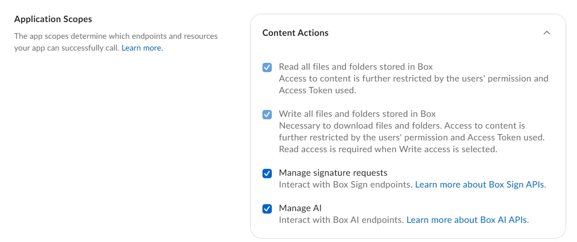

  1. In the Developer Console, open your application’s Configuration → Application Scopes and check that Read and write all files and folders (root_readwrite) is enabled.
  2. Save any changes and obtain a new access token. For OAuth, authorize the app again; for JWT or Client Credentials Grant, have your administrator reauthorize the app if its scopes changed.

 - We have already enabled Configuration → Application Scopes → Read and write all files and folders for our application as you can see in Screenshot attached.

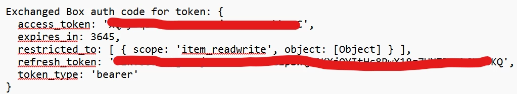

 - Token has read/write permission as you can see in below screenshot

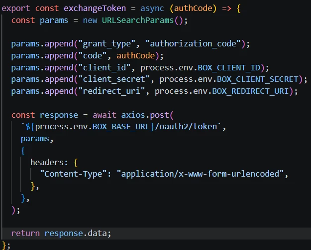

Our application is an embedded Box app, launched from the Box UI context menu. We use OAuth authorization-code flow to generate the access token. Below is the token exchange code we are currently using:
but we are still seeing the 403 Forbidden / insufficient_scope error when calling /2.0/notes/convert.
