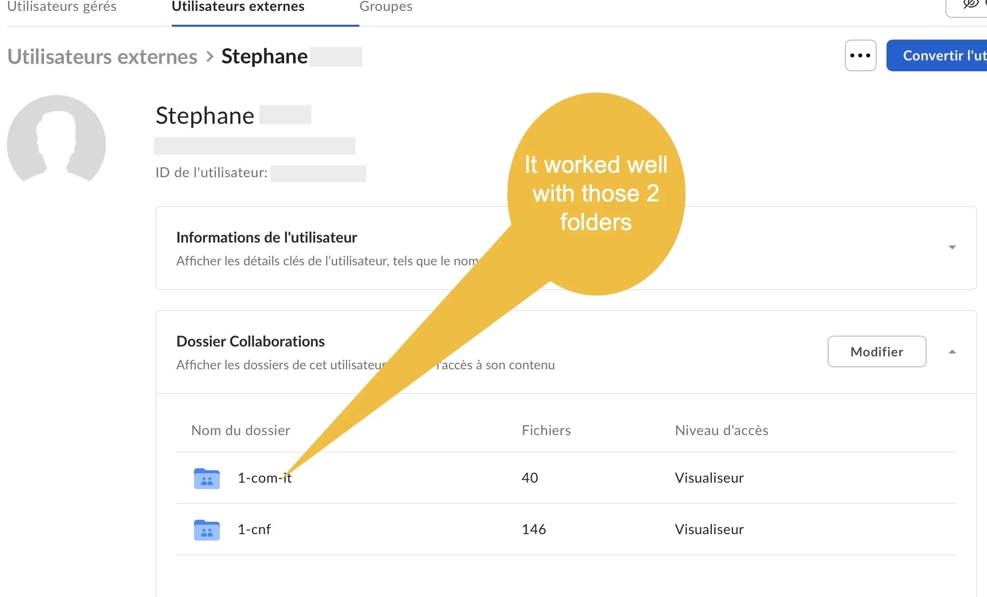

    I think I found the problem. Here is the solution in my screen copy. Those two folders are “connected” to my custom app so it’s normal that they have been set to the collaboration user.
    Now, I can’t find out how to add some other folders to my App
    maybe you can help.
    Thanks in advance again.

    Hello Rui, I found out, I juste had to find the email of my application and use it as an added user.
    Thanks a lot.

    Assuming that the FileMaker is the service user associated to the app, and you want to collaborate a folder owned by some other user,.
    For simplicity lets call the folder you want to share externally folder_to_share, the owner of this folder owner, and the service user FileMaker , you have 3 options:
    • In the folder_to_share add FileMaker as a collaborator - This seems to be the situation you have on your screenshot. Those blue folders seem to have been shared with the service user. From that point on the service client can access/see the folder_to_share. This manual sharing of folder might be harder to achieve.
