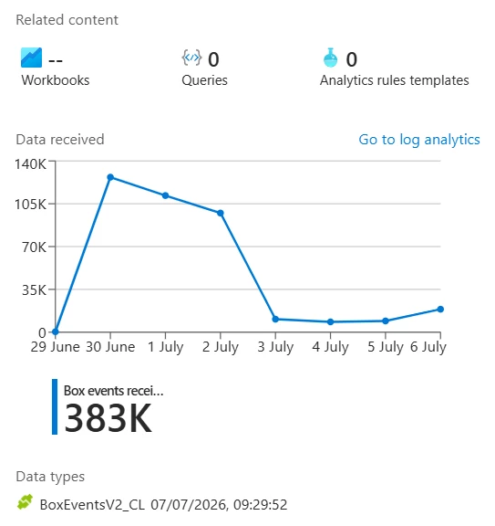

Hi everyone,
I have used Box Microsoft Sentinel Codeless Connector (CCP) connector which uses the REST API Poller to ingest Box Enterprise Events.
The connector authenticates using the Client Credentials Grant against the Box OAuth endpoint.
OAuth Endpoint
POST https://api.box.com/oauth2/token
Grant Type
client_credentials
Additional Parameters
box_subject_type=enterprise
box_subject_id=<Enterprise ID>
The connector configuration is similar to:
"auth": {
"type": "OAuth2",
"grantType": "client_credentials",
"TokenEndpoint": "https://api.box.com/oauth2/token"
However, the connector consistently fails.
Microsoft Sentinel reports the following error:
RES40001
Invalid Credential or cannot get credential for example OAuth2 access token.
Call failed with status code 429 (Too Many Requests):
Note that the credentials used are valid, Microsoft Sentinel Data Connector shows the following:
3 replies
You’re hitting API rate limits:
https://developer.box.com/guides/api-calls/permissions-and-errors/rate-limits
Easiest way to resolve is to leverage retryCount and Retry-After, and/or rateLimitsQPS.
Alternately, increase your polling interval.
