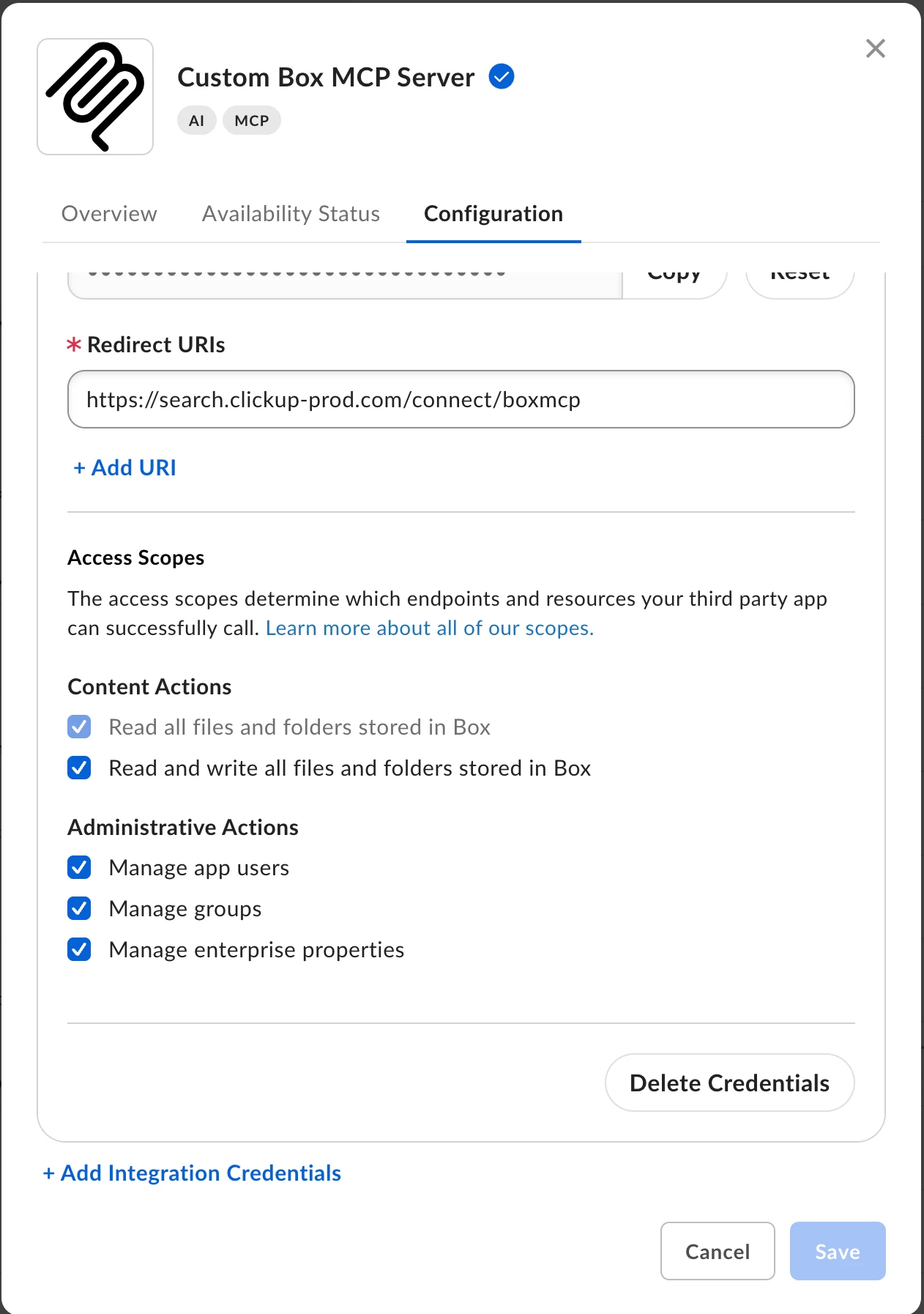

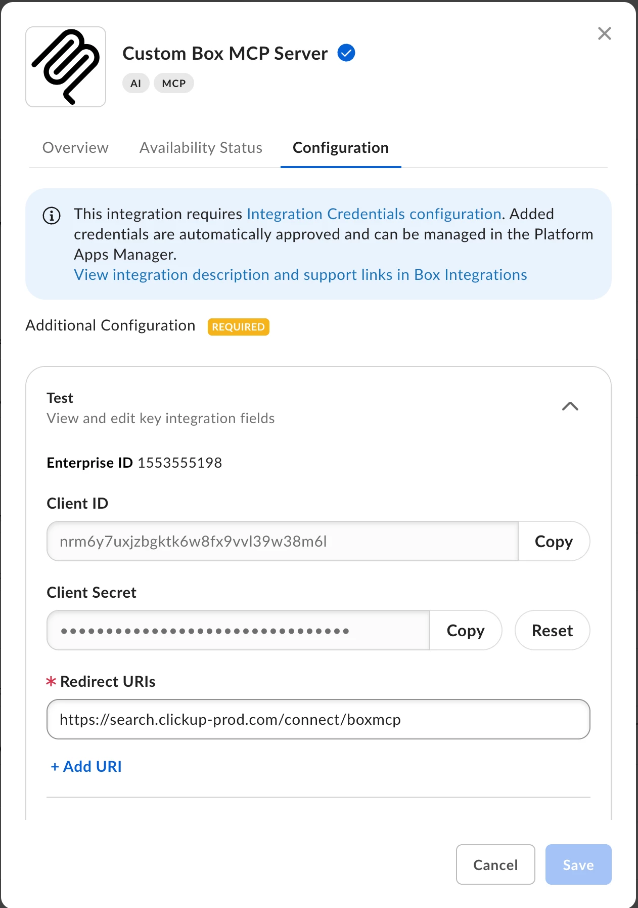

Hi ​@Jason S
Thanks for the reply. Here is a screen how it looks on my side:
Every field is set, but the Save button is not active. The state is not persisted, that’s why I was getting redirect URI mismatch, as my values is not saved.
Creating new Credentials does not solve the issue. I also tried in incognito mode, but still the same issue.

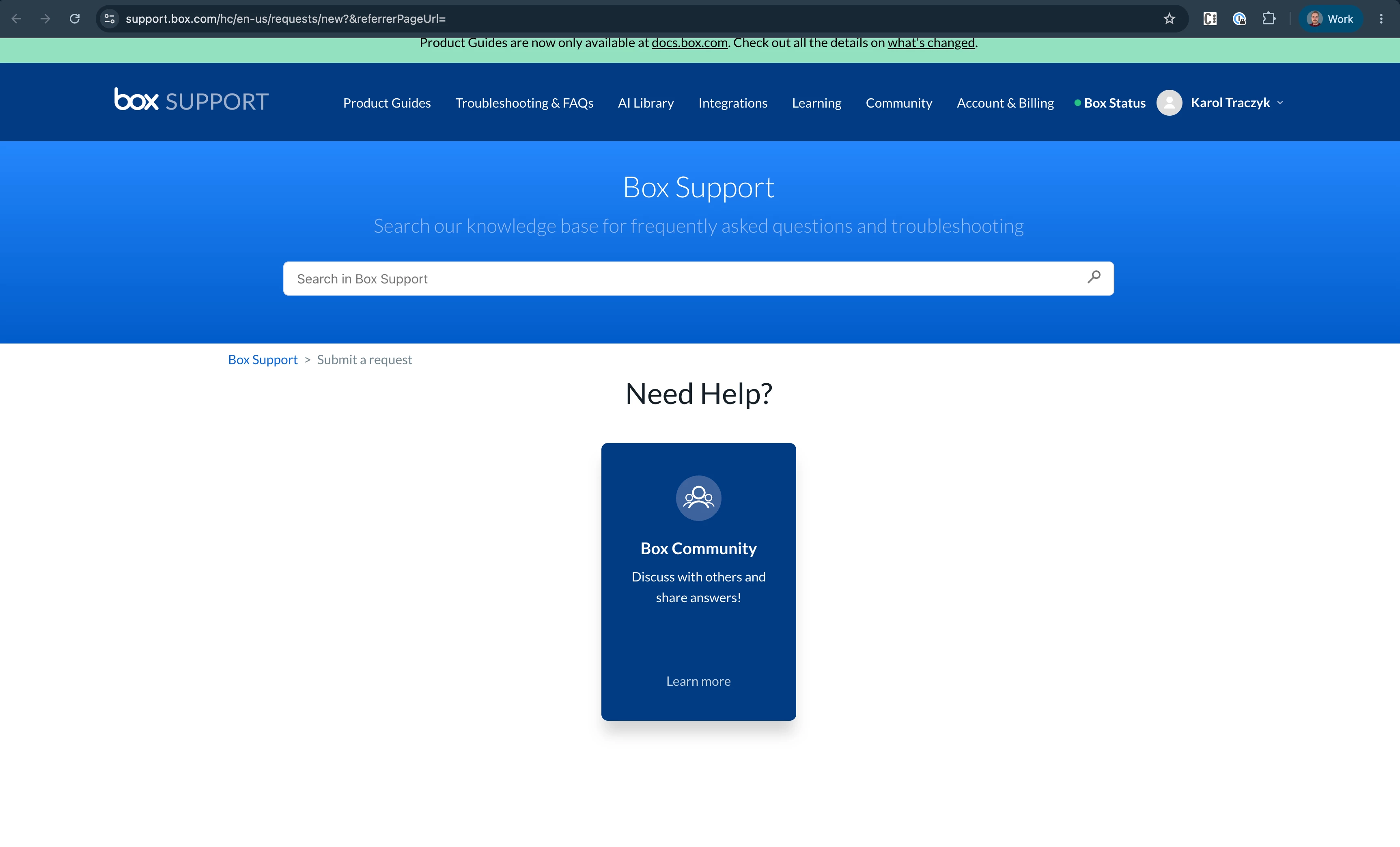

​@Jason S
How I can do it? I only see an option for Box Community, that’s why I posted it here 😅

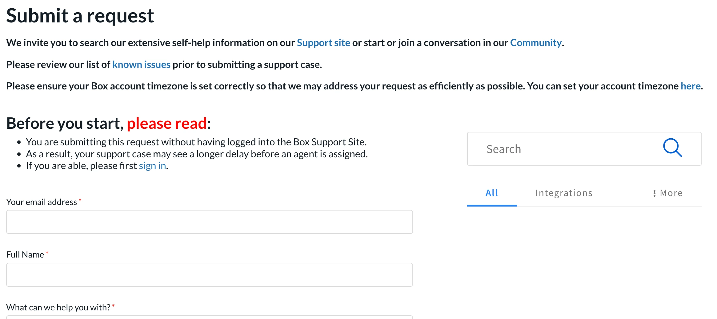

Jason S
  • Box Employee
  • October 5, 2026
Oh interesting! Does this link work for you?
This one works, thanks!
